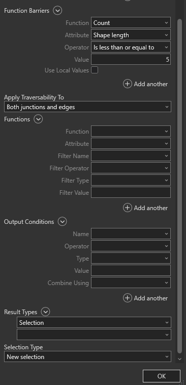

I had initially been looking at the Functions parameter, rather than Function Barrier, but I think Function Barrier is closer to what I am looking for. However, I am still not quite understanding what I need to do differently to get what I want.
Parameters for Trace:
My expectation from this would be an output of all point and line features where the count of traversed features moving upstream from each outlet point is </= 5, but instead it outputs a selection of every top (i.e. inlet, i.e. terminal in reversed flow direction) node in the entire network.
Apologies if I am not understanding something about your instructions, this is still very new to me.

RobertKrisher
There is no one trace you can do to solve this problem; you will need to construct a workflow (outlined above) to help answer these questions. Because this is a very specific kind of analysis, I recommend you post your questions on the water resources community site: Water Resources - Esri Community
It sounds like you're trying to areas of the network where there are less than 5 features upstream from your starting location. You are not going to be able to do this with any kind of function or function barrier, since those can only calculate statistics or cause a trace to stop prematurely. If these culverts are connected to an outlet, then you would need to analyze all your outlets to find them. If these culverts are disjoint, then you could first need to run a disjoint analysis and identify all the island in your network to determine which ones meet your criteria. This is a very advanced analysis that will take time to develop and understand, which is why I suggest you reach out to the water resources community to see if someone has a model they can share with you.
Here is an article that discusses the trace framework more in-depth: Exploring the ArcGIS Utility Network Trace Framework (esri.com) . It was written about the UN, but most of the concepts in this article are shared between the TN and UN framework.
