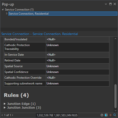

 Hi, i created my utility network  and i want to know how can i show rules in a pop-up like image below?

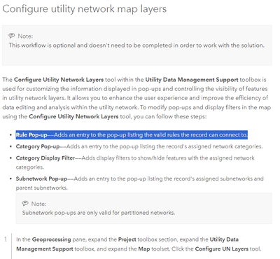

The process is described in full at the Configure a utility network environment help topic for the utility network foundations. In brief, you run the Configure Utility Network Layers tool from the Utility Network Data Management tools (included in the foundation) on your map.
