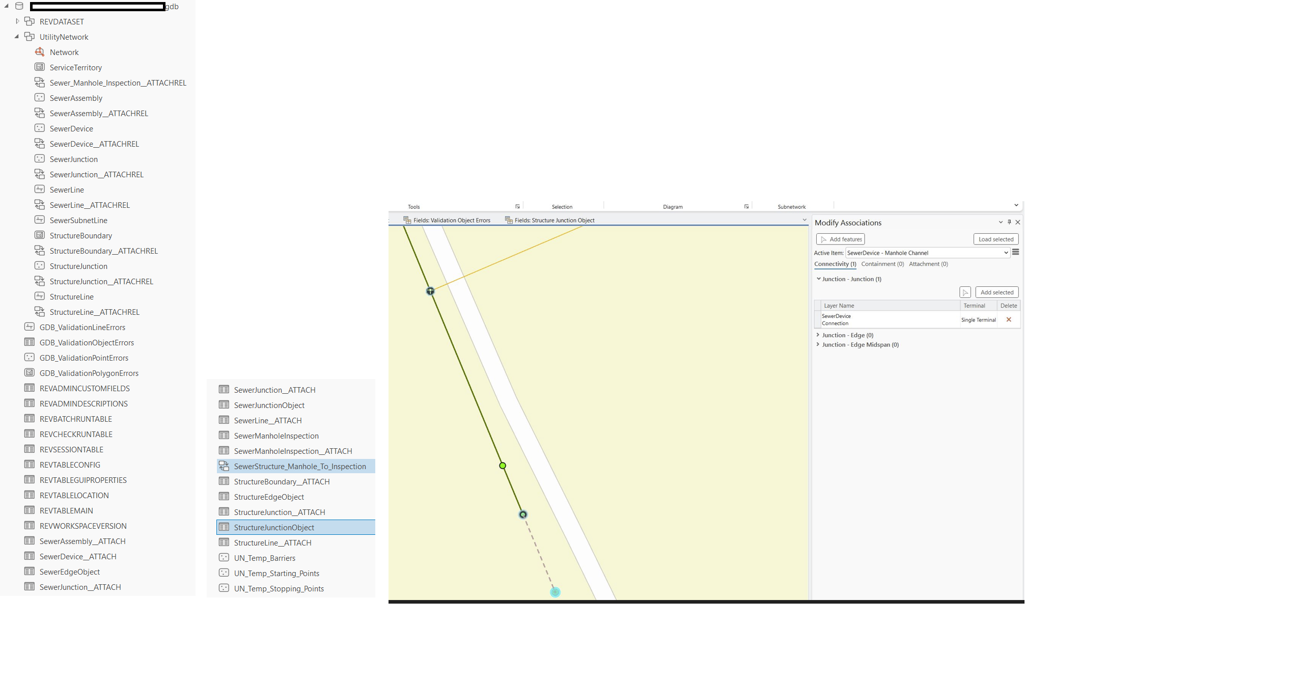

I upgraded ArcGIS Pro 3.3 to 3.5.4 and I noticed associations were not valid on the sewer network.  Single use FGDB.  UN Version 7.  Dataset upgraded from ArcGIS Pro 3.2.2 (Utility Network Version 6) to ArcGIS Pro 3.5.4 (Utility Network Version 7) on 2025-10-21
I am not sure what happened, Has any one experienced something similar?  What can be the fix?
Note: The associations are visible but not in the database.

Do you have a copy of the database from before the upgrade to see if this was still reporting an error? If you add the associations table to the map and query for the association between these two features, what do you see?
ELIZABETHFERNANDEZTRISTAN
Hello Robert,
I don't see an error or warning on the associations in previous Fgdb.  Can you let me know what tables for the  associations, see attachments?
RobertKrisher
The easiest way is to use the "Create Utility Network System Tables Views" tool in the Utility Data Management Support tools to add the layer to your map: Esri/Utility-Data-Management-Support-Tools: A set of tools to work with the utility network and thei...
