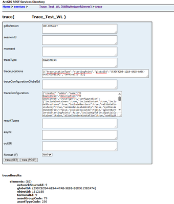

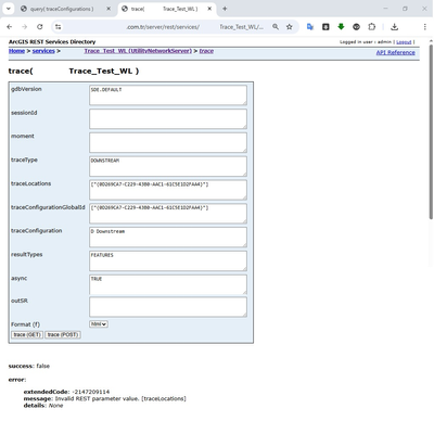

Hi all,
I am trying to trace via REST service, how should the trace location parameter be defined? Even if I remove the square brackets and double quotes, it gives an error.

I got it done, Thanks for the answers 😁

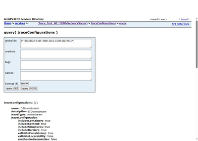

Fill in the trace Configuration parameter as a named trace parameter.

RobertKrisher
This question was posted at 2 AM my time 😀 The REST documentation for the trace operation is pretty good and would have helped you figure out what was wrong with your trace locations and trace configuration globalid parameters.
