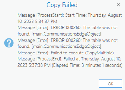

I tried it for Comms 1.4, but the copy of the feature dataset (fgdb to enterprise geodatabase) systematically fails at the same stage as the screenshot's message. Do you have any idea about what can be causing it to fail?
Thanks!
RobertKrisher
That looks like a bug, so you should log an issue for it. What version of ArcGIS Pro are you using? What version of the Comms model is that?
