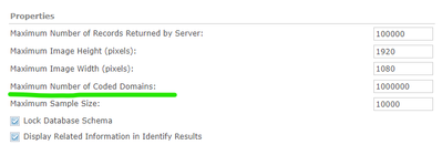

@angiexx1 - Assuming you have published the map as Mike suggested in the first suggestion, you can try Increasing the Coded Domains value on the service page and that has fixed this issue for us in the past.

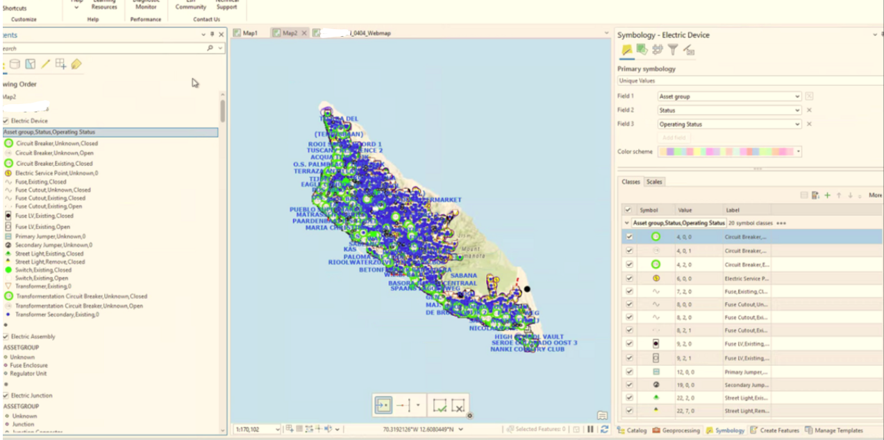

RobertKrisher
@angiexx1 in the screenshot above the symbology is using three fields (Asset group, status, operating status). Can you post a screenshot of the symbology on that layer in the map used to publish the service?
