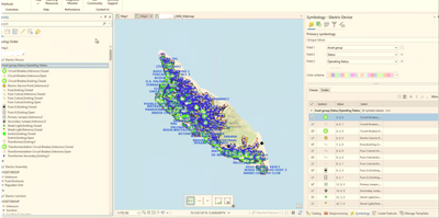

I have published my UN in the enterprise portal as a Webmap , also i have given the asset group as unique values to have the symbology but after publishing all i can see is coded domain instead of the description , how to resolve this? also when i have published without symbology the description worked correctly, but if i do with the symbology its not working correctly.

Publish the service rendered by the Asset Group.  This sets the type field in the service to the subtype.  In some clients, this is required to show coded value domain descriptions.  Then bring that service into ArcGIS Pro and symbolize like you want.  Share that back to your Portal as a webmap.

I have published the service using Asset Group for the symbology yet when i try to create its only showing numbers
RobertKrisher
@angiexx1 in the screenshot above the symbology is using three fields (Asset group, status, operating status). Can you post a screenshot of the symbology on that layer in the map used to publish the service?

There is also a setting in the map service that you might need to increase.  "maximum number of domain codes"
