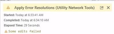

samshrma998
I have been encountering same issue. For me I am getting a warning message ang log file saying "an edit operation is required".
I am running the tool to correct stacked points and have error resolution defined as "Delete all but first".
Surprisingly , the tool work as expected on AGP 3.5.1 but gives warning in AGP 3.5.5 (attached screenshot).
Further, when I add and use the standalone toolbox which I have been using in past during AGP 3.3, it works well in AGP 3.5.5 also.
Is there any additional things to consider while using this tool on 3.5.5.

RobertKrisher
@samshrma998  @streamside . If you receive a warning when applying the edits, then it's a known issue (BUG-000181823). If the tool doesn't report any warnings or errors, but no resolutions are applied, then that is not something we are aware of, and you will want to log an issue, so support can investigate what is happening.
