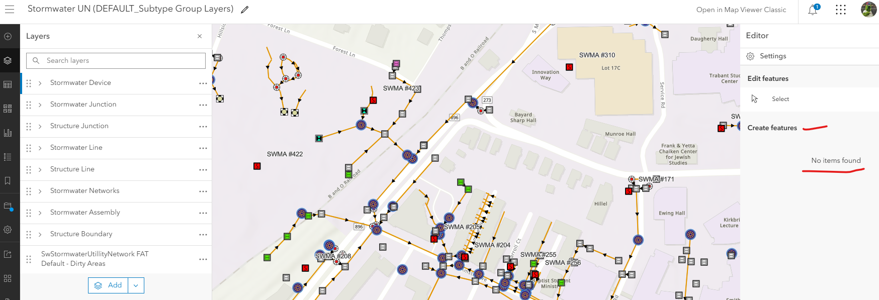

Greetings from Newark, Delaware's Public Works and Water Resources Department.  We have been migrating our geometric networks to utility networks in our test environment (Enterprise 11.3) starting with stormwater and sanitary sewer.  We have published feature services and created web maps.  In our stormwater web map, 'Edit features' appears to be working as expected, but 'Create features' is not.  No templates are present (see screenshot).  In our sanitary sewer web map, the Create feature templates exist.  Comparing the feature service settings, web map settings, etc. between the services and web maps have revealed nothing we can identify as the cause.  Any insight into the cause and remedy would be greatly appreciated.  Thank you in advance.
JayHodny
Decided to publish a new web map, same layers and publishing settings as before.  New web map now shows 'Create features' templates in edit mode.
