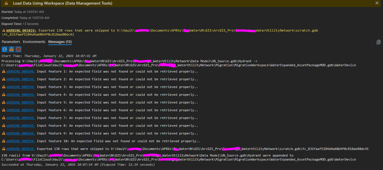

Hello, I am having a hard time with the Load Data Using Workspace tool right now. This is a redo of what was a successful data load into the Water Expanded Solution about a month ago using the exact same source data.
Create Simple Data Mapping works fine. Create Migration Workspace works fine. When I run the Load Data Using Workspace, I get the following errors for every feature in my migration:
I have tried making a fresh download of the solution's atbx, the "untools" atbx, and the Asset Package.
Only things modified for the Asset Package are the Change Asset Package Spatial Reference tool, one B_Rules addition, a few Subtype default changes, and removal of the Asset Groups and associated relate classes/tables for those not needed.
Then, the Load Data Using Workspace tool shows the error shown above.

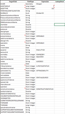

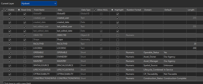

auustinreeves
Running the Update Data Loading Workspace Schema added some association/tier/subnetwork fields to the mapping table, as shown below (everything after the "symbolrotation" field). I've included my source's fields as well for reference.
Am I missing something? The only field that is not in the mapping, but is in my source, is OBJECTID. This was not added when running the update schema tool (I added it manually for a test, but got the same result). Still getting the error on Load Data.
