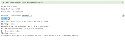

MatheusSparapani
Only the water or sewer service. I also tried running the process directly using the Reconcile Versions tool in ArcGIS Pro, without adding the features to the map—just by entering the service URL directly in the tool and executing it.

MatheusSparapani
Yes, this error is probably the same as the one described in that bug. I tested it in an 11.5 environment and I was able to reconcile and post without any problems.
