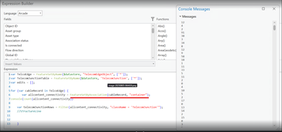

When trying to use the FeatureSetByAssociation Arcade function for Connectivity Association type, we are not able to fetch the associations, it just returns an empty result.
When we use the Container association type it is returning correct record counts of the associated features

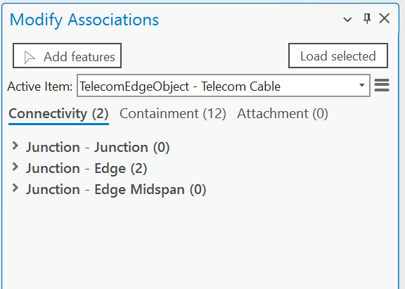

For example with this first TelecomEdgeObject record, we have 12 Containment and 2 Connectivity Associations:
When we try to use Arcade:

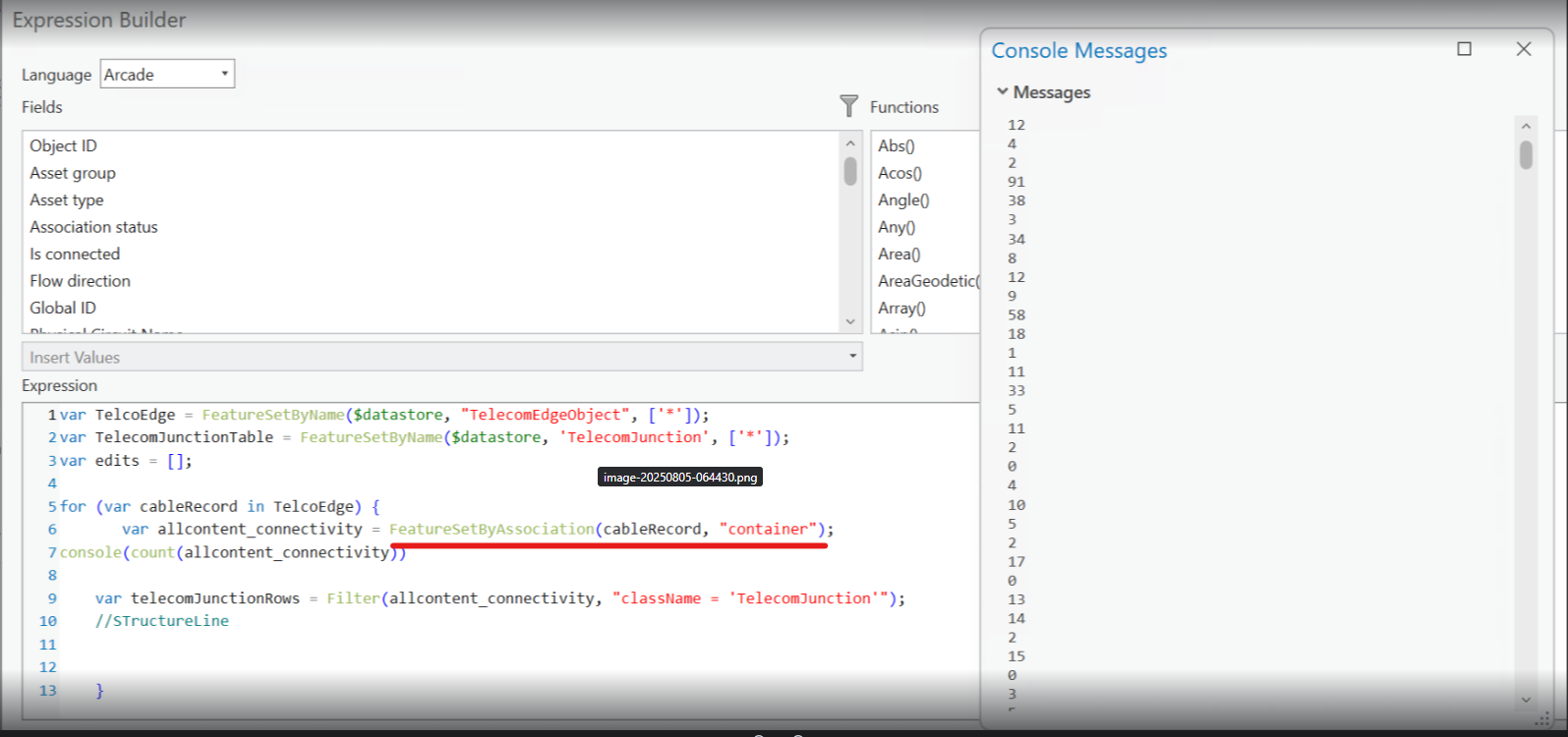

Containment:
Returns 12 as count of associated features

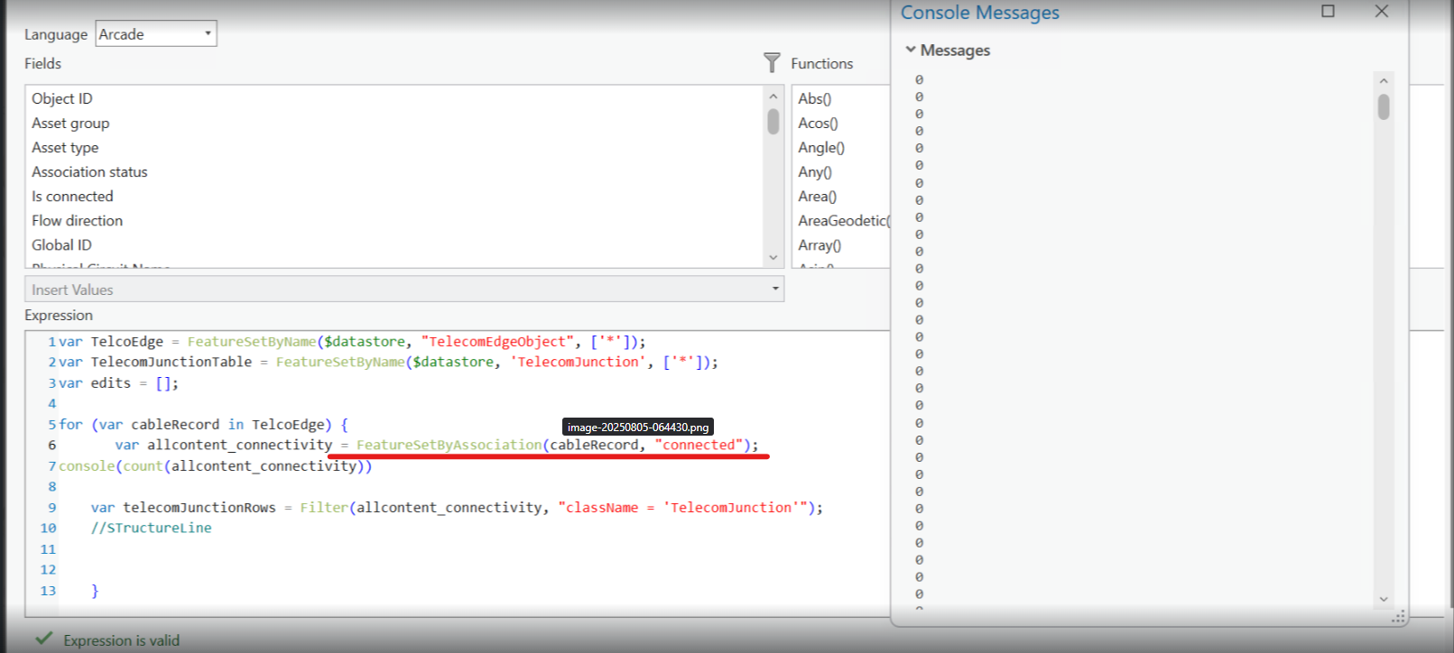

Connectivity:
Returns 0 as count of associated features
What could be going wrong here? We tried creating an association(connectivity) manually, and it still does not consider it.
Any thoughts would be helpful!!

If you are looking for junction Edge associations you should use
featureSetByAssociation($feature, 'junctionEdge')
"Connected" is only for JJ associations
6 Replies
RobertKrisher
I recommend you check out the Arcade documentation for that method for the possible values for the association type parameter: FeatureSet functions | ArcGIS Arcade | Esri Developer.
I don't see 'connectivity' listed as a valid value. Depending on the type of connectivity you're looking for, you should be able to use one of the other association types.
Yogesh_Chavan
Thank you @RobertKrisher,
We used the "junctionEdge" and it worked.
HusseinNasser2
Yogesh_Chavan
Thank you @HusseinNasser2,
We used the "junctionEdge" key string for this and it worked.
