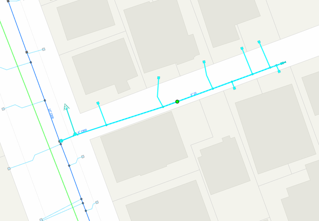

  • Enterprise in big subnetwork -  does work on a cul de sac, but very slow

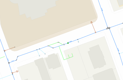

  • Enterprise on a "gridded" street in the big subnetwork Warning with no results

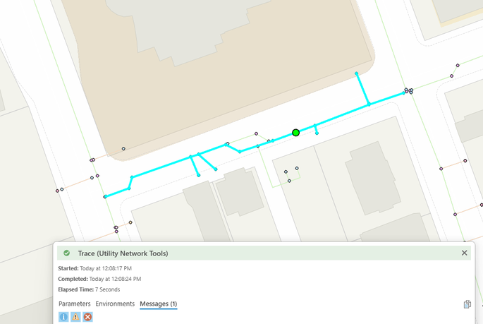

  •    Same spot, on the mobile gdb (good machine), trace works and fast.
