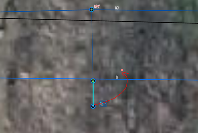

I have tried this using Data Interop, and also using the "snap" tool in ArcGIS Pro. The snap tool returns an empty geometry error (somehow causing the line to collapse on itself)
Screenshot below showing the point I want to snap the line to.
moving the points (service connection) isn't the issue, for some reason it is collapsing the lines when trying to snap to the new point location. Any thoughts on this? I am only trying to snap lines to the new service connection location using endpoint snapping, trying to determine if this is violating a constraint. We are using the out-of-the-box attribute rules, and the only one I could think of that might be preventing this is the "set rotation from line angle"
