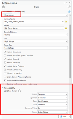

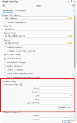

gis_KIWI4
MVP Regular Contributor
The Connected Trace has no Condition Barriers by default this behavior is different when you select the downstream/upstream trace. When you select these traces the condition barriers are inherited from the subnetwork definition.
