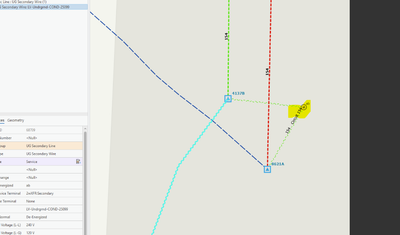

BryanMay531_0-1743454223025.pngThese low voltage services from one transformer need to b phase and the one service connected to both needs to ab (or abc, not sure).  How do I do this in the UN?   Right now its propagating all to ab.
2 Solutions
MikeMillerGIS
Esri Frequent Contributor
You need to draw different lines.  I am guessing one transformer is set to just a and one is set to just b?  If so, the services that are both ab, need a line from each, the ones from just a, need one line.
BryanMay531
Thanks.

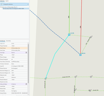

I think I have what you are describing though.  Maybe I need to set phasechange on the highlight line to b and the other to a after the transformer?
MikeMillerGIS
on that line, yes, or on the xfr
BryanMay531
How do I get abc to propagate to this service?
