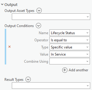

Use a condition barrier to stop the trace, then add an output condition to only return the in-service features:

Ah, it's that simple. OK, thanks, I was focused on input rather than "output" conditions.
Does this mean we're filtering only the lines being traced? What about the water valves, in this case? What if we have a few LifecycleStatus = Removed valves, will those be ignored, too?
RobertKrisher
Condition barriers apply to all the features in your trace unless you specify otherwise, so it is used to stop the trace at ALL out-of-service features. The output filter applies to ALL the features returned by the trace, so it will filter out the proposed features where the tracing stopped.
You can control which lifecycle status values are included and excluded by modifying your conditions.  You'll likely set it up to only include things that are in service or pending removal (if that's in your workflow/model).
