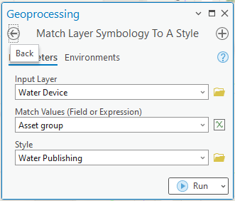

Ah, I found out. As you said at least one by one. It would be good to know how to apply whole UN in one step (if its possible):
Geoprocessing/Data Management Tools/Layers and Table Views/Match Layer Symbology To A Style
