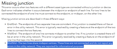

Our data already has vertexes basically anywhere two lines cross. Any chance there would be a simple way to eliminate these vertexes?
RobertKrisher
The Migration toolset that was released in ArcGIS Pro 3.3 can identify and remove these vertices if you want to (Missing junction mid-mid). They are hidden from the error summary and resolution tables by default, since they don't cause topology errors, but if you turn off the filter you can use the tool to delete them. The tools are discussed in depth in these articles:
