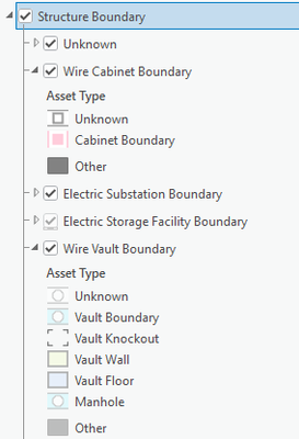

Joshua_Moreno
Hi Robert, I only see "Electric Substation Boundary" as an Asset Type under the Structure Boundary class. I would like to add vaults, manholes, and pull boxes as structure boundaries to be symbolized as polygons instead of points. Would this require the editing of the asset package schema in the essentials model?
RobertKrisher
Most of those asset groups and asset types exist in the expanded model. This means you can use the Create/Apply Network Copy workbook tools to import them into your asset package. You can read an article about how to use them here: Solution tools to help with data modeling and data migration.
I'm not aware of anyone creating structure boundary for underground/surface structures with smaller footprints (pull boxes, pedestals, junction boxes). You could add these as additional asset types to cabinet/vault boundaries (relatively easy to implement). If you wanted to create new asset groups, you would need to be careful to set up all the domains on the new subtype, in addition to all the steps required to create a new asset group. There's an overview that guides you through this process in the Configure a utility network topic in the ArcGIS Online Help. You would make the data model changes on the asset package schema (make a backup first), then put the corresponding configuration in the various B_ tables in the asset package.
Joshua_Moreno
Ahh gotcha, this is perfect. I've currently been using the essentials model so seems like best course of action would rather switch over to the Expanded or just import them into my existing asset package via the tools you mentioned.
