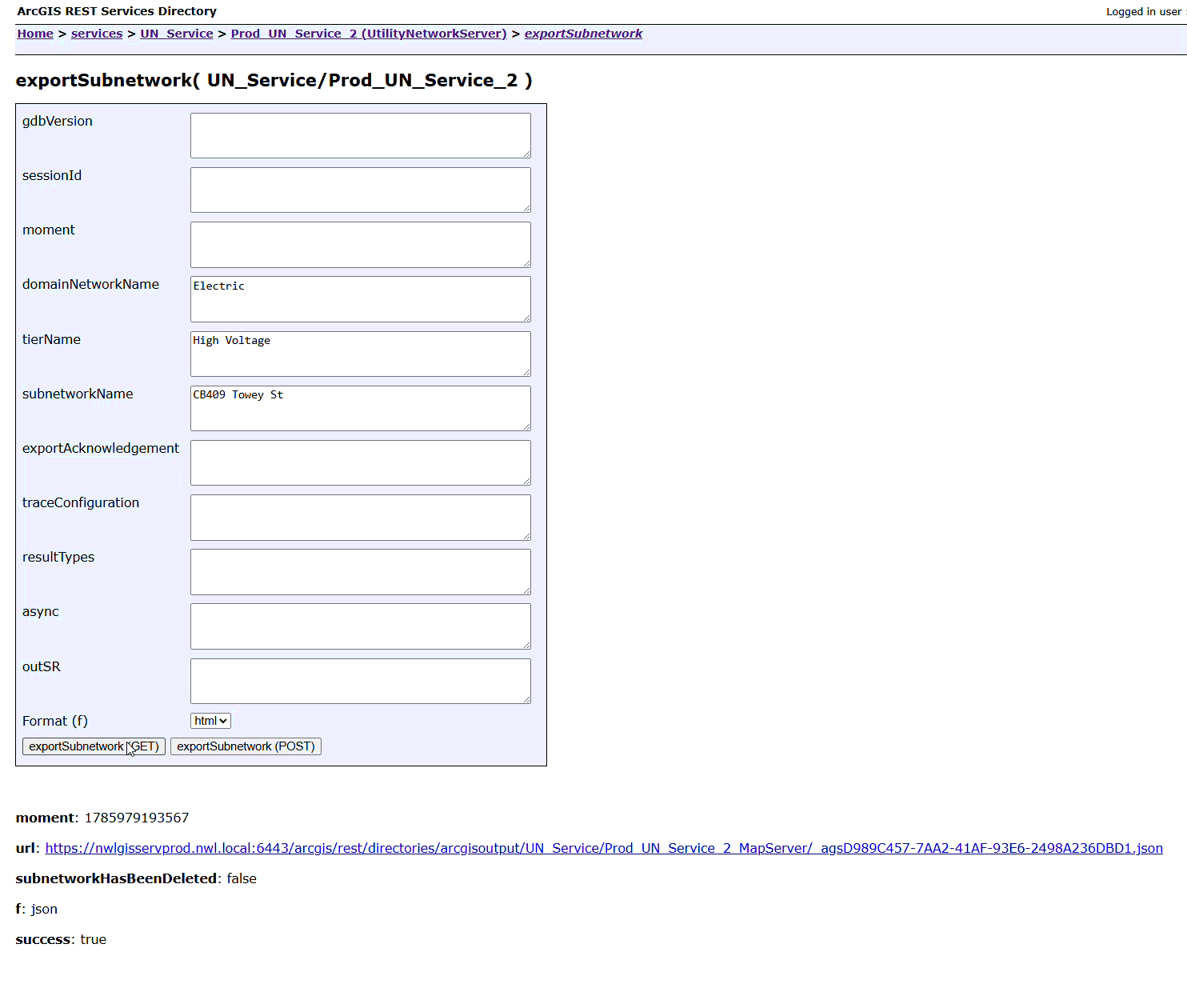

I am trying to programmatically export all subnetworks. This used to work before but now it seems to be failing and I cannot quite put my finger on the problem. I have tried using FME.
But the issue seems to be on the server side, to test this I am using the browser.

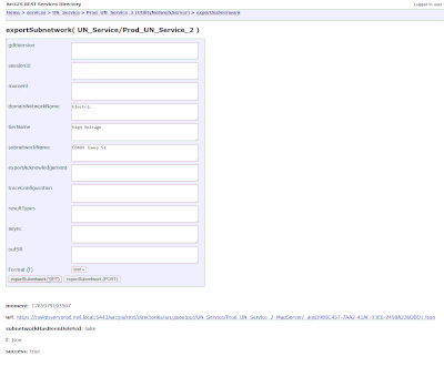

It works, works, fails, then works again. GIF Below.
"message": "Dirty subnetwork cannot be exported."
Anything I am missing?
The subnetworks are definitely not dirty.
All processes are working off the Default Version.
11.5
I can probably get past this by using retry mechanisms but it so weird this is happening.

I restarted the service and it seems to have come right for now.
I will monitor this as we continue through this project.
