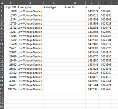

Scenario 1 - Run a trace. Select a bunch of Low Voltage Service in the table widget. Export CSV.
Data is missing.

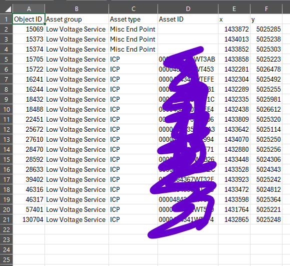

Export it again, it seems to work.

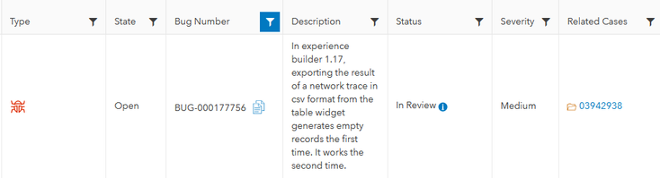

FYI BUG-000177756 has been addressed
Enterprise 12.0 / ExB 1.18

I've already opened a case a few months ago for your first issue, it was also present un 11.3 and Esri support reproduced in 11.5
BUG-000177756

I didn't specify, but the bug was in version 1.15 of Experience Builder Developer Edition, used with AGE 11.3.
Also reproduced by the support team in ExB 1.17 Dev Edition, which is also the default version in AGE 11.5.

Bug is still in review
