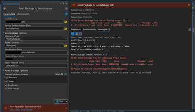

We have created a UN v6 using Pro 3.3.5 and then extending the latest Esri foundational data model. We are now attempting to publish that to an Enterprise 11.1 environment. However, we get a "Domain code is invalid error" regarding the BIGINTEGER domain value defined within the AP_Attribute_Types domain, which is applied to the "attribute_type" field of the B_NetworkAttribute table. However, we've confirmed the value is not actually being used by any records. Attempting to remove the value renders all feature classes unreadable. We've confirmed our asset package is UN v6 and all objectIDs are 32-bit.

After reading your question more closely, please post a screenshot of exactly where you are seeing this error. If you are publishing a deployed utility network to ArcGIS Enterprise it should not contain that table, domain, or coded value.

The image says it's still virus scanning (50 minutes later). Maybe try embedding it directly in your post?

let's try this...

That is not publishing, that is trying to create a new UN File/Mobile Geodatabase with 3.1 ArcGIS Pro. The asset package scheme is a 3.3 schema. Our foundation solutions only support 3.3 and 3.5.
You need to create the UN gdb with 3.3 or greater, then use copy and paste to your enterprise GDB.

That screen shot was from a subsequent troubleshooting step.
We have a hard requirement for Enterprise 11.1. Is there an alternative approach for applying the solution schema to a UN v6 without rebuilding the desired asset groups/types from scratch? I seem to recall you mentioning in the past that the solution schemas could be applied/downgraded to earlier versions, but I don't recall the steps. Or I mistaken?

Have you tried using ArcGIS Pro 3.3 to publish to 11.1 enterprise?  That domain with the big int is only an asset package domain, once you have a UN, it might be compatible with 11.1(lots of other variables, attribute rules, etc).
You can use 3.3 to create the UN and then use 3.1 after that too.
