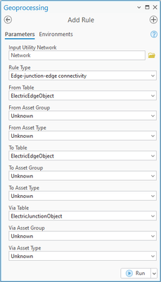

Is it possible to create a edge junction edge connectivity through a Junction object in arcgis utility network.
I intend to try this to connect domain line features of different asset type. But when tried to add rule, the JunctionObject feature class isn't available in the options.
Any advice on this is much appreciated.
Thanks
RobertKrisher
You can only create Edge-Junction-Edge connectivity (and rules) for Electric Junction Objects with other non-spatial objects. You can find the full list of how different types of features are allowed to be connected on the feature restrictions page of ArcGIS Help.
For Domain Junction Object to appear with an Edge-junction-edge connectivity rule, both the From Table and To Table must be Domain Edge Objects.
