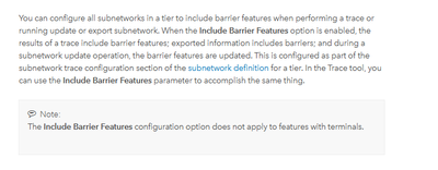

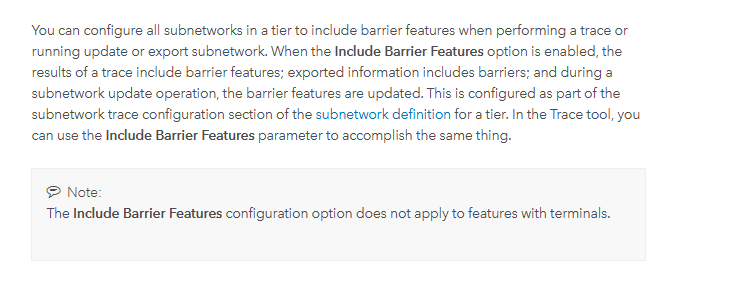

Our team is currently setting up a workflow in which we need certain open devices to not have a subnet name after updating the specific subnet. I wanted to use this option:
And uncheck this option in the set subnet definition tool, but the problem is that the device in question is a transformer and has a terminal. The note in the documentation says that it does not work with devices that have terminals.

This is currently not possible with the software, but if you model the fuses or elbows on the high side of the transformer as a separate device, you can open that device to isolate the transformer.
