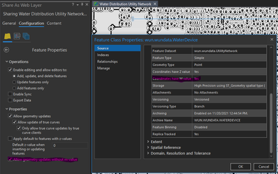

JimmyBowden
As Mike indicated the Utility Network feature classes are M enabled when they are created.  If you are deploying your UN as an enterprise you will want to check the box "Allow geometry updates without m-value" in the Feature properties.  This will set the M value to NaN when features are created. At this point you can just ignore them.
