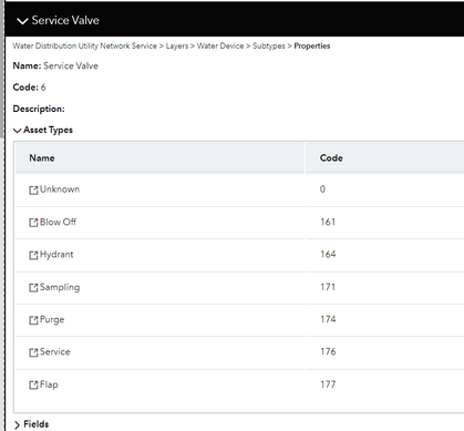

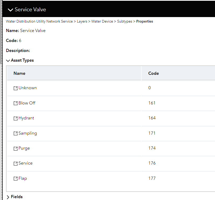

I found some issues in understanding how some parts of the network link to each other, because the Utility Network Data Dictionary lacks in some descriptions. For example, for the Water Devices, assetgroup Service Valve, there are no descriptions, even if I click on the assettypes (image below).
Will the data dictionary be updated? Is there a way to find more descriptions?

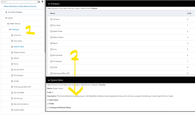

There is an issue with the Service Explorer, where it is not loading descriptions when navigating to the Subtype via the contains pane.  If you navigate to it via the Subtypes link, it loads the descriptions:
