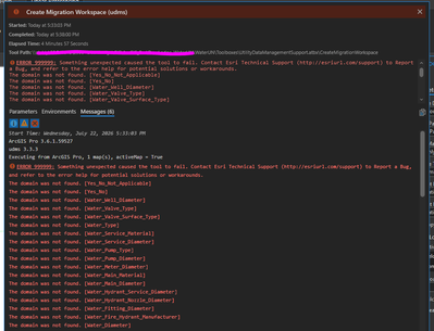

Hello,
As the title states, I am getting a list of errors specifying "Domain Not Found" for every domain in the Asset Package. The Asset Package and Source GDB contain the same domains (Water UN Expanded defaults). The tool worked yesterday; now it is erroring, and I cannot figure out why.
Any thoughts?
Thanks

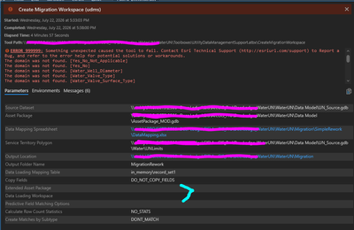

@MikeMillerGIS, yes, I am on a network for my org. The inputs are:
I did just notice the (aqua) missing parameters that I normally see on this tool's msgs.
