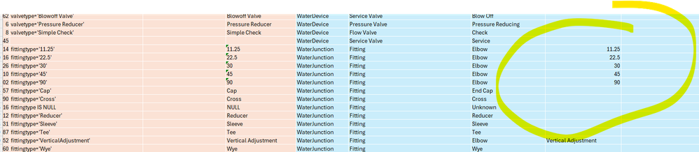

To close out this question, Mike discovered what my issue was.  In the Simple Data Mapping spreadsheet I was attempting to create new Asset Types that were only numbers:
Even setting the column as text would still result in them being seen as numbers by the GP tool.  So I added some text in there in addition to the numbers and was able to run the Create Migration Workspace tool successfully.
