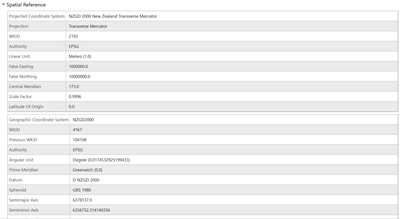

Hi, can you please post a screenshot of your populated rules table? Ands also the coordinate reference system of your data since this determines the units of your distance field.

The coordinate system of the data is

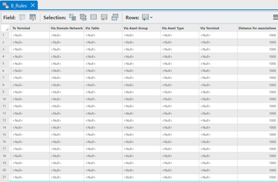

Below is the screenshot of the Rules table:
I have modified the distance of each association.
LizAbbey
Thanks for sharing those - are you able to also send the area of the rules table to the left that shows the rule type and the from and to asset group / asset type? Just trying to get a full picture of your set up.
