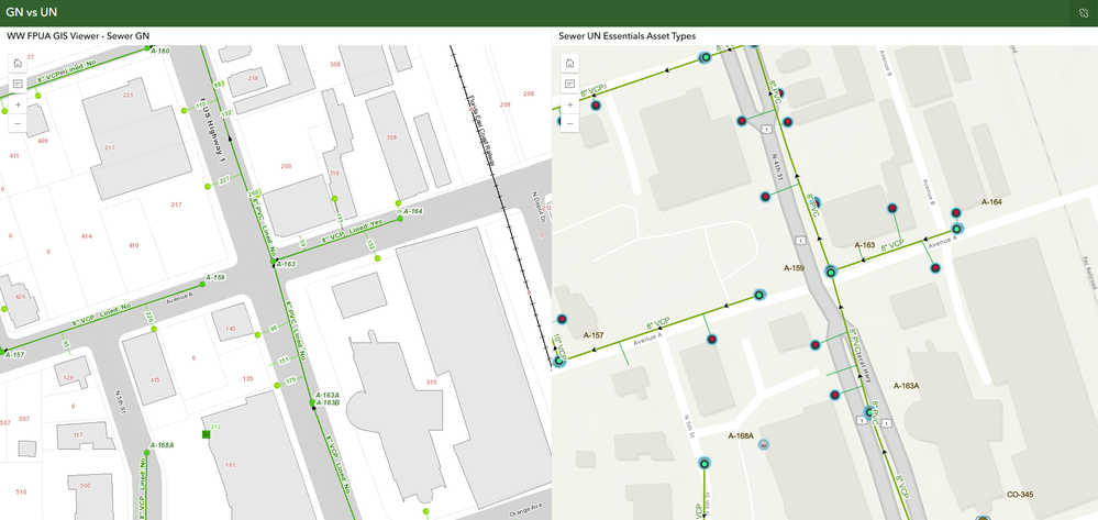

As we progress beyond concept, they are going to want to see something.  ***Please be aware that this is untested and only a concept thus far.***  I had planned to use the Compare Instant App with two maps synced together.  One with the GN Map Service and the other with a UN Map Service.  Sync the maps together and sync the popups so they can see both the map display and attributes showing the differences between the two.  You would need to have some sort of pilot area migrated to the UN if you are planning to use the clients data to show this or perhaps you could get some data from a previously successful migration or Naperville.
