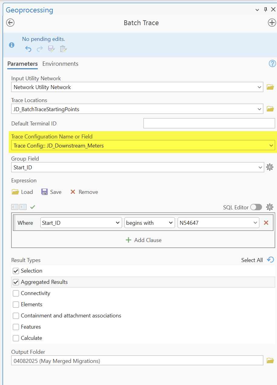

I have a feature class populated with trace starting points.
I have a trace configuration returning only meters downstream of the trace starting point.
And I am able to successfully execute a batch trace using the geo-processing tool as long as I am only returning aggregated geometries.

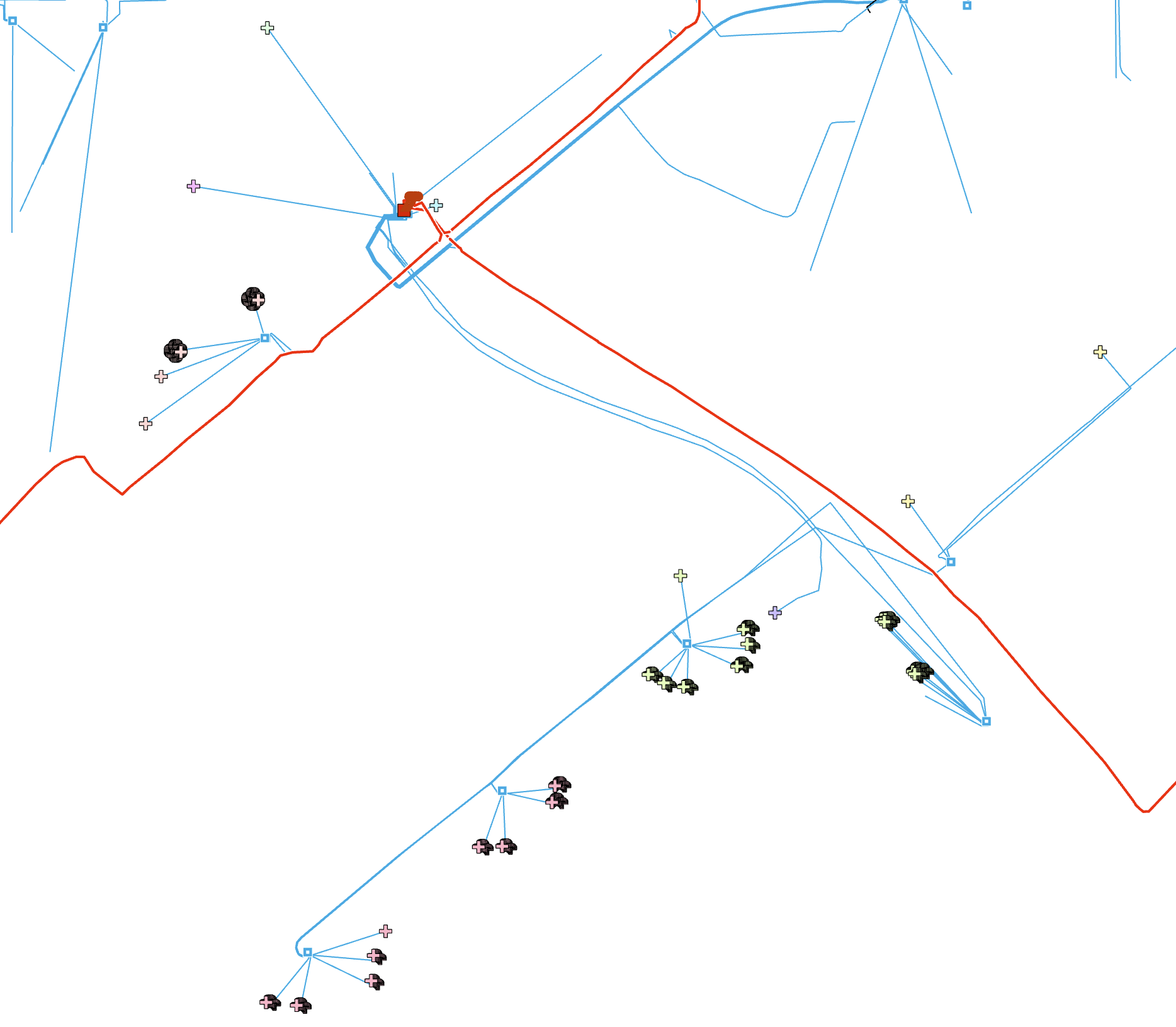

The result is a feature class showing downstream meters (point features) that I may symbolize by the group field (Start_ID).
So far so good. I am struggling to make the next step, though.
Hence, I actually do not need the aggregated point features.
Instead, what I need is to have the batch tracing tool count all meters encountered downstream of each trace starting point and write this count to the Meter_Count attribute (LONG) in the trace starting point feature class.
I am aware of the documentation (https://esri.github.io/Utility-Data-Management-Support-Tools/docs/3.1/BatchTrace.html) as well as on the video-walk-through (https://esri.github.io/Utility-Data-Management-Support-Tools/help/BatchTrace.mp4).
I cannot seem top get my head around how to actually accomplish, what I want, though.
Yeah, it comes down to ticking off the Calculate option - but after that, I am left not really finding the documentation / demonstration or with a brain unable to understand the approach.
Help, please 🙂

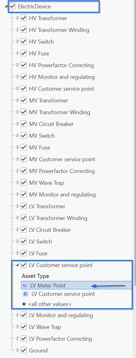

Output has no affect on functions/summaries.  Output is strictly a filter of the result selection set.  You need to set up the function to count the meters.  I like to use Network Categories for this.  So create a category for the items you want to count.  Then set up the Function to Count/ObjectID or some other field on the device class, really does not matter, Categoery isEqual Meters

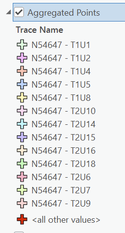

The Group Field has already been set to Start_ID as described above:
This is what is already populated onto the Trace Name attribute on the generated Aggregated Points:
This really doesn't relate to the calculation as such, does it?

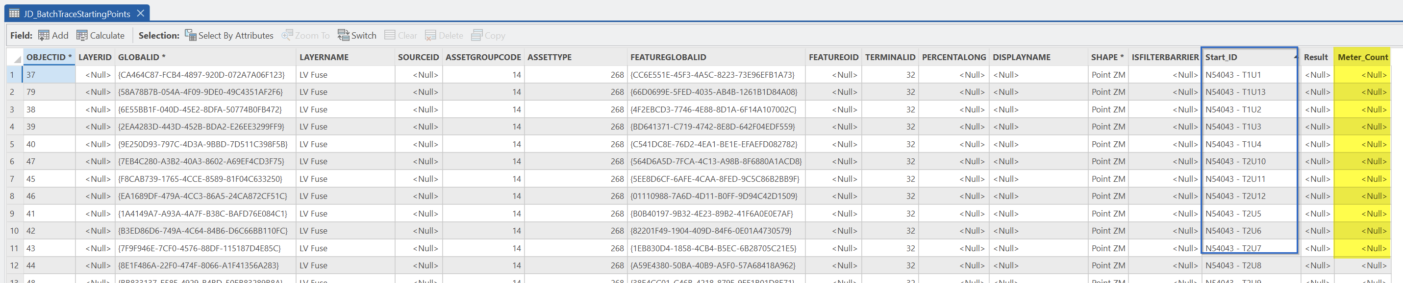

Now, as I want to calculate the count onto the trace starting points and not generate aggregated geometries, I disable Aggregated Results and enable Calculate:
This engages a new section in the GP-configuration, and I am asked to specify the attribute to which the calculated information is to be written:
I notice that the attributes shown come from the JD_BatcgTraceStartingPoints feature class - that's good.
But I also notice that apparently I am only allowed to write the calculated results to attributes with data type TEXT - and hence not to the intended attribute Meter_Count
It seems I will have to update the schema but for now I just choose DisplayName as target:
I believe, by this I have set up writing trace results to the DISPLAYNAME field on the starting point features.
Jens_Dalsgaard
Thanks for taking the time to clarify this, Mike.
So batch tracing requires you to create and assign a network category (or network attributes?) to the asset types to be counted?!?
