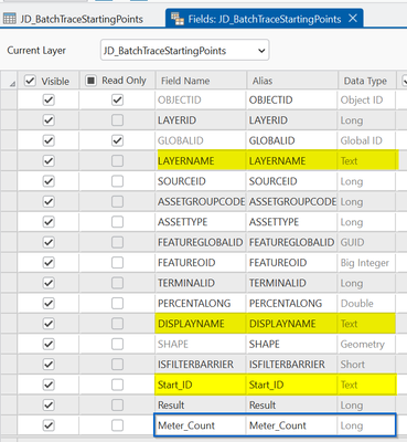

I have a feature class populated with trace starting points.
I have a trace configuration returning only meters downstream of the trace starting point.
And I am able to successfully execute a batch trace using the geo-processing tool as long as I am only returning aggregated geometries.
The result is a feature class showing downstream meters (point features) that I may symbolize by the group field (Start_ID).
So far so good. I am struggling to make the next step, though.
Hence, I actually do not need the aggregated point features.
Instead, what I need is to have the batch tracing tool count all meters encountered downstream of each trace starting point and write this count to the Meter_Count attribute (LONG) in the trace starting point feature class.

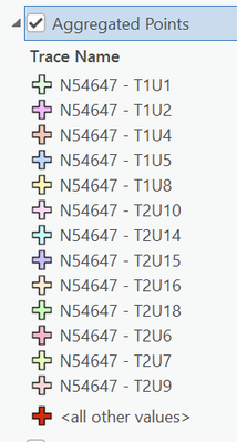

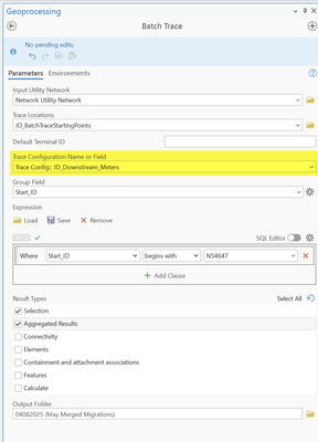

The Group Field has already been set to Start_ID as described above:
This is what is already populated onto the Trace Name attribute on the generated Aggregated Points:
This really doesn't relate to the calculation as such, does it?

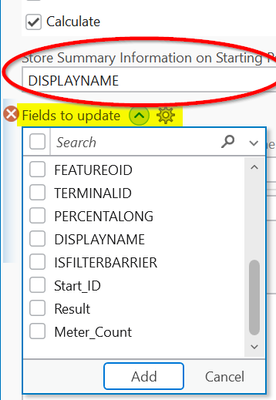

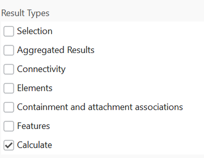

Now, as I want to calculate the count onto the trace starting points and not generate aggregated geometries, I disable Aggregated Results and enable Calculate:
This engages a new section in the GP-configuration, and I am asked to specify the attribute to which the calculated information is to be written:
I notice that the attributes shown come from the JD_BatcgTraceStartingPoints feature class - that's good.
But I also notice that apparently I am only allowed to write the calculated results to attributes with data type TEXT - and hence not to the intended attribute Meter_Count
It seems I will have to update the schema but for now I just choose DisplayName as target:
I believe, by this I have set up writing trace results to the DISPLAYNAME field on the starting point features.
It is after this that it becomes blurry to me.

The Fields to update drop-down reveals fields from the trace starting point feature class, so I'd assume, this is where I specify storing results on the JD_BatchTraceStartingPoints:DISPLAYNAME fields.
But - what is this compared to the Store Summary Information on Starting Points information (red ellipse above)?
Generally, this section is a complete mystery to me:
And the built-in documentation doesn't help me out:

A text field is required, because what is stored is the result of a trace with summaries.  The result of a summary is returned as a string, like @VenkataKondepati was mentioning.
To create a trace config with a summary(function-https://pro.arcgis.com/en/pro-app/3.3/tool-reference/utility-networks/trace.htm#GUID-C96D0B7D-9E41-4...), you need to run a trace, and fill out the summary details.  Then run Trace to Trace Config(http://esri.github.io/Utility-Data-Management-Support-Tools/docs/3.5/Trace2Config.html) or use the Add Trace Configuration with and fill out the function section(https://pro.arcgis.com/en/pro-app/latest/tool-reference/utility-networks/add-trace-configuration.htm...)

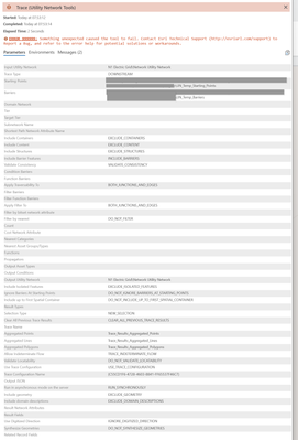

Trying to execute this new trace configuration (returning the count) returns an error though:
ERROR 999999: Something unexpected caused the tool to fail. Contact Esri Technical Support (http://esriurl.com/support) to Report a Bug, and refer to the error help for potential solutions or workarounds.
What am I doing wrong here?

Assume this is services?  If you turn on debug logging, does the server log provide any additional details?
That trace configuration is not complete, you just listed Count.  What do you want to count?  I am guessing there is not a lot a validation on creating a trace configuration.  Best option is to make the trace and use the Trace to Trace Configuration tool.  That way you can ensure the trace is completely working.

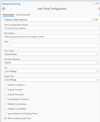

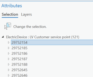

Let me start by first add a trace configuration returning downstream meters as a selection:

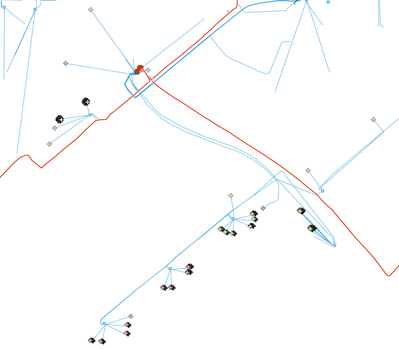

The above trace configuration correctly return the downstream low voltage meters as a selection:
All good so far.

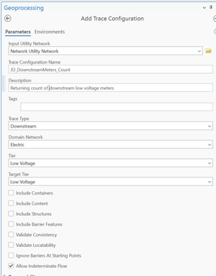

Next, let me add a trace configuration returning the COUNT of downstream meters only:

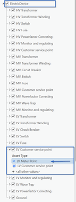

Now, this is where I get lost ;):
What I aim to count is the number of low voltage meters reached - blue rectangle.
But, should I fill out any of the parameters with yellow highlighting above? And if so, should I simply count occurrences of an arbitrary network attribute, that I know will be filled out?:
And how about Result type?

MikeMillerGIS
Esri Frequent Contributor
Output has no affect on functions/summaries.  Output is strictly a filter of the result selection set.  You need to set up the function to count the meters.  I like to use Network Categories for this.  So create a category for the items you want to count.  Then set up the Function to Count/ObjectID or some other field on the device class, really does not matter, Categoery isEqual Meters
