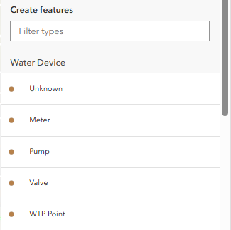

I follow the same step > publish by Asset Group > Add UN layer in Map Viewer > Symbolise by asset type. But the issue that I am facing is that when i tried to create new features, seem that it still refer by asset group? Any idea on this?
Symbolise by asset type in map viewer after publish by asset group from ArcGIS Pro:
When i want to create features, it still point to asset group
Is this something I should expect? Coz i thought i would be able to create features based on asset type directly instead of asset group as my symbology is now pointing to asset type. Am I following the correct flow of symbolising the asset?

In terms of creating/managing editing templates, those are driven by your symbology by default. I typically use ArcGIS Pro to author templates, and regardless of what your symbology is you'll want to ensure that each template sets both the asset group and asset type of the feature so snapping and validation works properly.

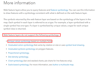

We tried to symbolise it at map viewer directly by changing the symbology field from asset group to asset type, it works. But it has limitation that we can only symbolise by one field for feature service, which we actually looking for symbolising using both field (asset type and status).
Limitation of symbolise in map viewer

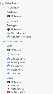

This is what we have done for SGL (picture below) in desktop level and we want to bring it to web application level., especially on tracing apps, so user can differentiate the type of valve. We tested to publish the following in SGL, just that the asset participate in SGL cannot be selected when i try to make a selection on map and like u said, will have issue on domain code.

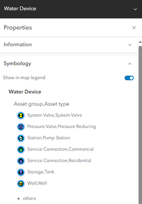

When you publish the service do not symbolize using anything but the asset group. If you do that there are a known series of bugs that will cause things to not work. You must symbolize your feature service using the asset group and then do all additional symbology/configuration through your web map. You should author your web map using ArcGIS Pro and then share it as a web map to your portal. This is the best practice outlined in the article above: https://community.esri.com/t5/arcgis-utility-network-blog/best-practices-for-working-with-utility-ne...
Some widgets (like the trace widget and experience builder) currently do not support subtype group layers, but you can work around that pretty easily.

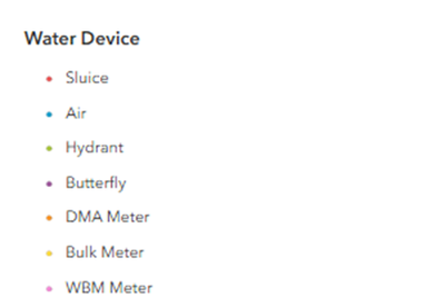

For web maps that can't use subtype group layers, you author a map in ArcGIS Pro that symbolizes features using multiple fields, using a regular feature layer, and publish that as a web map to be used with your web applications. Below is an example of the legend from a Map I published this way to support an experience builder app. I symbolized using asset group and asset type, but I just have easily included device status as well.

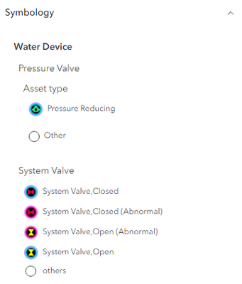

Remember that there are some apps that do support subtype group layer. For example, the Web Editor application (released at 11.3) does support subtype group layers. In the example below I have the same data with subtype group layer, but I'm symbolizing each valve based on its asset type, present position, and normal position (to identify any valves in an abnormal status).

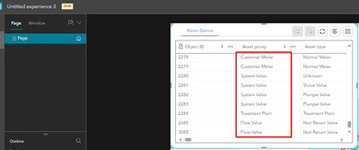

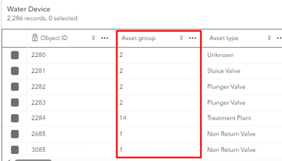

Hello @RobertKrisher  , thanks  for detailing out the steps. I published in Asset Group and symbolise using Asset Type in ArcGIS Pro, then share as web map. It seems okay, but when I look at its attribute table, the Asset Group change to code, but in ExB, it shows description. Any idea on what steps I might be missing?

For any strange behavior you are seeing, log a case with support. They can look at the specific behavior you are seeing and get you attached to the corresponding bug or provide you with guidance on how to configure the system appropriately.
