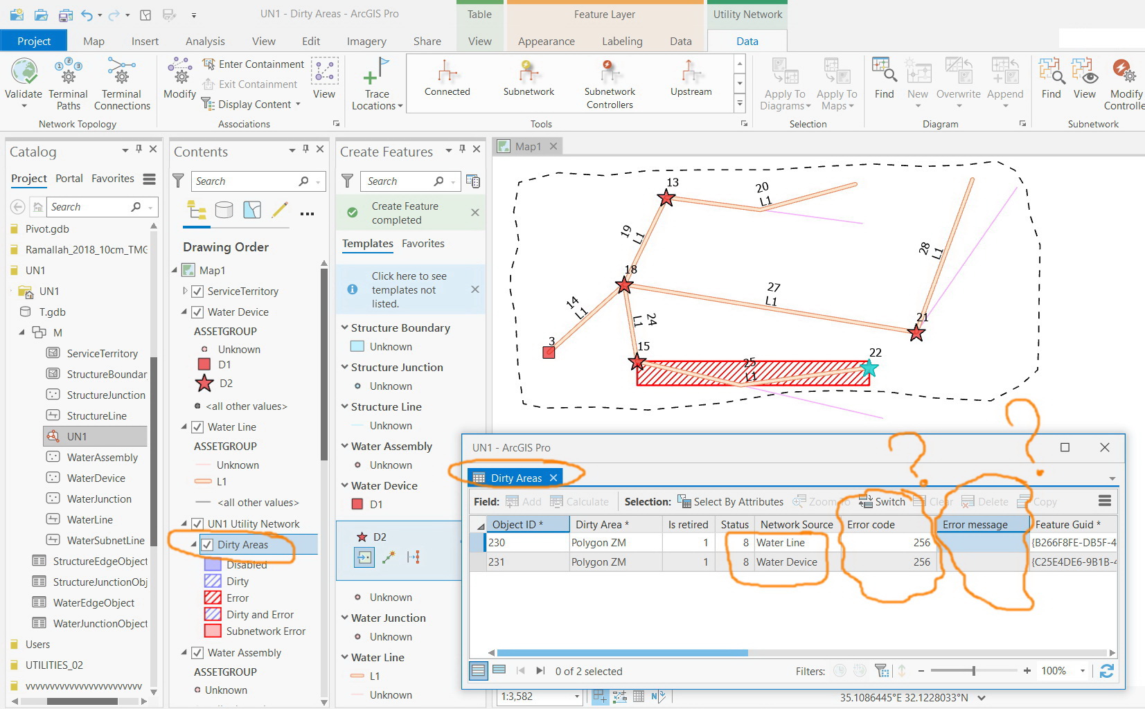

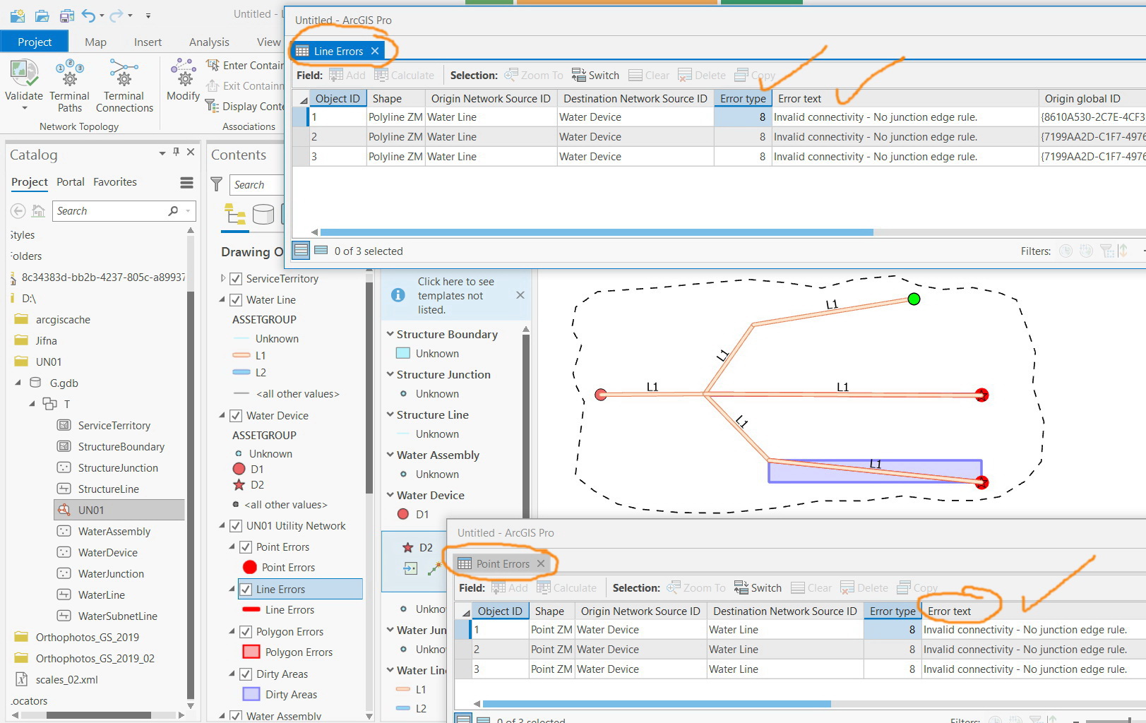

In Pro 2.5, the Utility network topology error table is used to include “error text” field that explains the error. This field appears not to be available.
Also, I couldn’t figure out where is the explanation for the “error code”. For example, what is the meaning of the error code # 256?

A dirty area in a utility network schema 4 can represent multiple error conditions. A schema 3 utility network had a 1:1 representation between number of errors and number of dirty areas. In order to represent multiple errors on a single feature, the codes as a power of 2 are summed and stored in the error code field.
The error message field you see in your screenshot is still used when there are dynamic error messages (eg, a rule ID or network attribute name)
