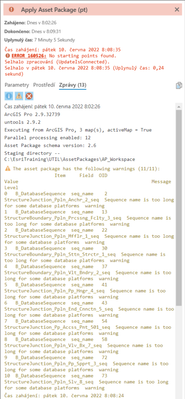

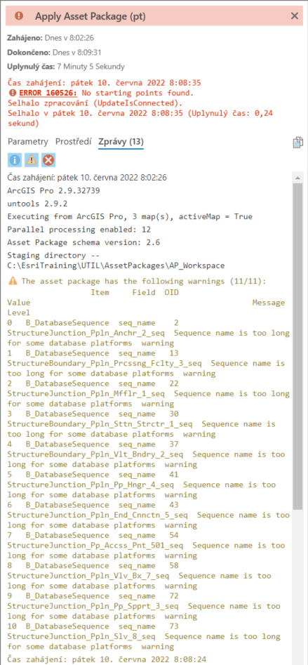

It returns me this message:
 There is one ERROR and several warnings. First of all i will need to resolve an error.
ERROR: 160526, WARNINGS see on printscreen + one warning is in Czech language, i sent the number: WARNNING: 002553 related in this topics:

Hi Marian,
The current version of the UPDM solution is 2.1. This should be used with ArcGIS Pro 2.9 and is currently only available for download in the ArcGIS Online Solutions app. Future versions of the Solutions app in ArcGIS Enterprise will include the newest version, but for now, the version available in the Enterprise Solutions app is currently out of date.
The solution documentation and link for deployment is located here: https://doc.arcgis.com/en/arcgis-solutions/latest/reference/introduction-to-gas-and-pipeline-referen...
I recommend downloading this new version and going through the steps again. Please let me know if you encounter any errors after doing so.

Hello,
thank you for additional information. I have tired to deploy this version of asset package with data from this package, rather v2.1. Everything seems, that is running in this version. I tryed to combine data from this package with tools form older one at first. It seems that it is not recommended. I have some experiences with working with varyous versions of asset package, e.a:
