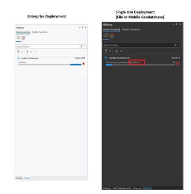

Hi all,
During the Subnetwork Update process, the subnetwork name does not appear in the Geoprocessing panel. If you work on File gdb these Subnetwork Names are displayed. In this way, we can see which Subnetwork is updated within the Tier.

MikeMillerGIS
Pretty sure this is because on Service, it uses an Async process.  F/MGDB do not support an async process.
From the help:
  • ALL_SUBNETWORKS_IN_TIERAll subnetworks in the tier will be updated. This option uses asynchronous processing to update the subnetworks using the system UtilityNetworkTools geoprocessing service. The service is reserved for utility network geoprocessing tasks and has a longer default timeout setting. This is the default.
