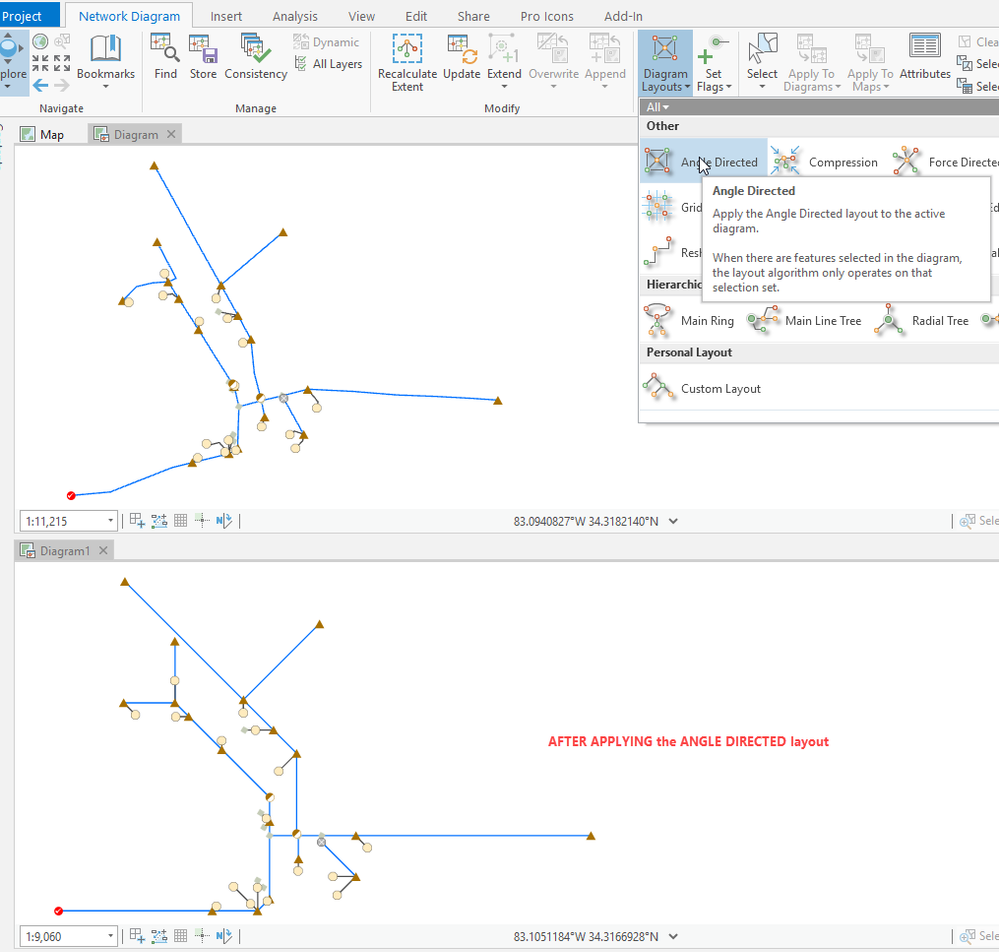

Hi @Anonymous User @Anonymous User
After having a quick look at your Start and Objective diagram images, I think that the Angle Directed layout should do the job in your case!
Please find the sample diagram below before/after applying the Angle Directed layout
NOTE: you will have to increase the Number of Iterations parameter value to get the result you want. In the sample case below, I run the layout with Number of Iterations = 150
Thanks
Anne-Yvonne

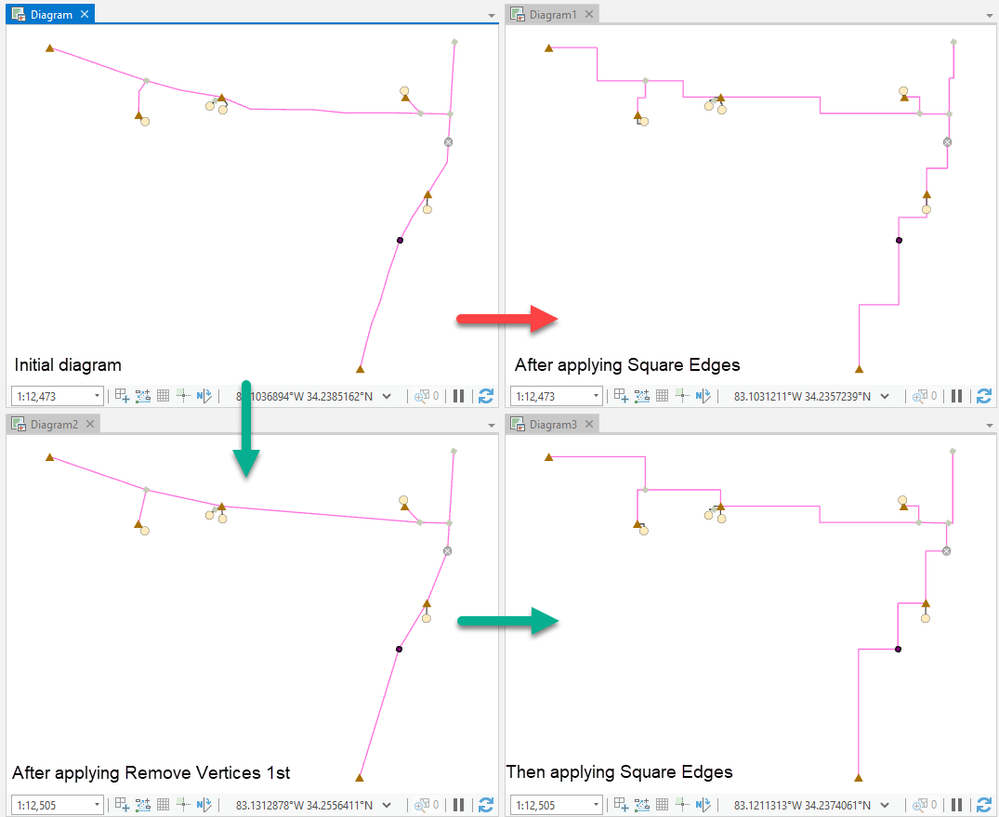

Hi  @Anonymous User,
Maybe I misunderstood what you explained above. Please find some other suggestions below.
By default, with the 3 default installed diagram templates, the vertices along the diagram edges are always kept on the generated diagrams.
1/ Solution 1
If you generate a diagram based on one of these 3 templates, apply the Reshape Diagram Edges layout with the Remove Vertices operation first. This will remove all vertices along the diagram edges, so you end with straight lines between each pair of connected junctions in your diagram (see Diagram 2 below).
Then, re apply the Reshape Diagram Edges layout once again with the Square Edges operation (see Diagram 3 below). This should square the diagram edges as much as possible like you expect.
2/ Solution 2
Following the steps detailed in this help topic section, create your own "custom" Basic, CollapseContainers or ExpandContainer templates with another name. When configuring the Alter Diagram Template tool, please keep the "Keep initial vertices on edges" option unchecked for your use-case.
If you want to get the Square Edges operation automatically executed at diagram generation, you can also run the Add Reshape Diagram Edges Layout tool with its default settings.
Hopping this will help
Anne-Yvonne
