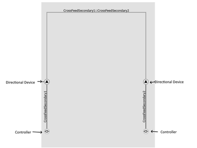

MikeMillerGIS
I am not sure if this will work for you, but you can cross feed subnetworks if you have directional devices below the controller to ensure the controllers cannot trace to each other.
Jens_Dalsgaard
Many of the double-feeding scenarios are in nature temporary and hence dealing with the requirements described above in a - let's call it - static way as suggested here doesn't seem right.
