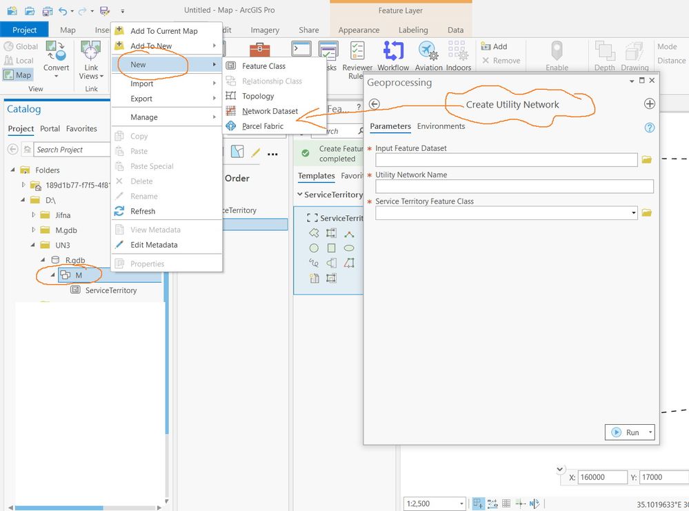

ArcPro 2.4.2: The “create utility network” tool is not available when right clicking dataset,
I observed that the “create utility network” tool is not available when right clicking dataset. In ArcMap, the create Geometric Network is used to be there

Jamal - Geometric Networks can only be brought into AGP for display and query -- creation/editing of GN's are only available in ArcMap.  For AGP, the developers are creating a new Utility Network as referenced in this link here.

I never mentioned that I need to create GN in Pro! All what I wanted is to have the “Create Utility Network” tool available when right clicking the dataset in Pro! That’s it
I just compared with ArcMap due to the fact that one can create GN by right clicking the dataset.

Apologies - you're correct.  I got confused due to the screen grabs of ArcMap vs. AGP.  Until the right-click option is available, you can modify the Quick Access Toolbar to add the "Create Utility Network" GP tool to that toolbar.

ArcGIS Pro 2.7.2: Having the “create utility network” tool when right clicking the feature dataset class,
It would be great if the ArcGIS Pro to is enhanced have the “create utility network” tool when right clicking the feature dataset class

Great idea that we have in our items to add in the future. I believe you have logged an idea similar to this in the past.
https://community.esri.com/t5/arcgis-utility-network-ideas/arcpro-2-4-2-the-create-utility-network-t...
I merged these ideas together.
MelissaJarman
Status changed to: Under Consideration
This is a nice accessibility item that we are looking to include in a future release. While you can still navigate to the tool manually, this context menu at the feature dataset level will improve quick access.
