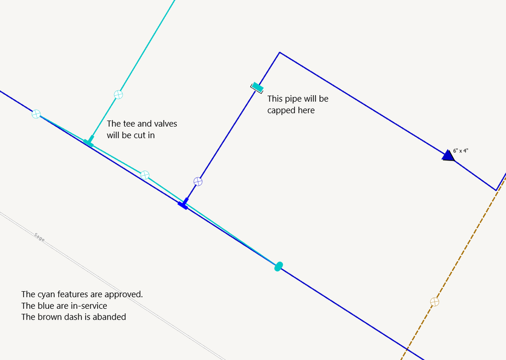

For context we are using a modified version of the Water Distribution Solution.  The system and pressure subnetworks have a condition barrier "Lifecycle Status Does not include any (bitwise AND equals False) Specific value In Service and To Be Retired".
In the image below the cyan are approved features and the blue are in service.  When we go to build the subnetwork the approved valve, cap, and coupling act as barriers (as expected based on the condition).  Everything to the right will not be included in the subnetwork.
RobertKrisher
Ah I see now. Modelling in-line proposed install/retired features is one of the trickier items to model because, as you noted, the system treats the new features as barriers (to ensure they are not included in the subnetwork). If you are going to be at the Esri UC I would love to sit down with you at a whiteboard with someone from our water industry solutions team to draw out several of the ways you can handle this.
