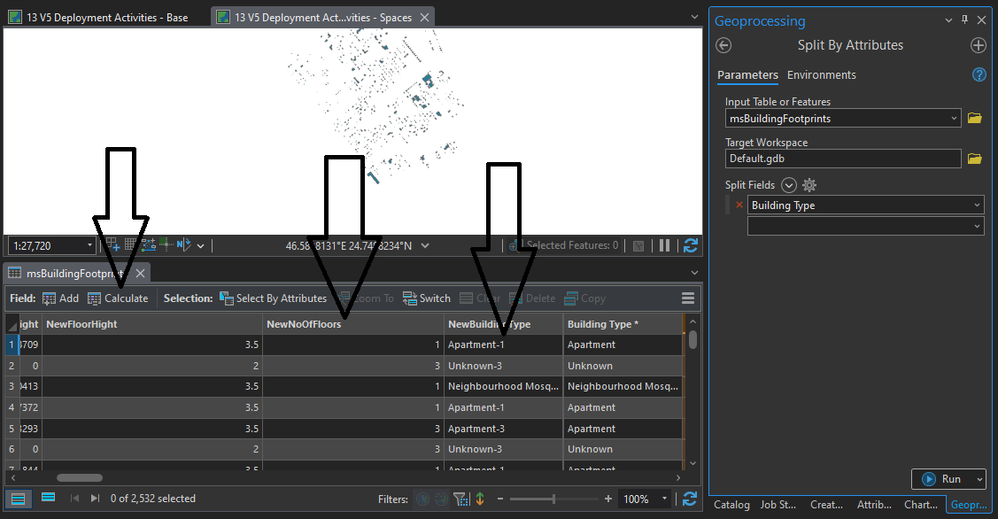

  • I am preparing the building footprints, where each building type corresponds to a space type.
  • Each space type (building type) has unique attributes such as floor height and number of floors.

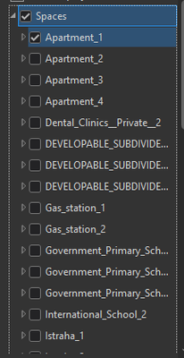

  • I split all building features by attribute and then upload each space type into the ArcGIS Urban development section.
My specific questions are:
  1. Is there a way to upload all building types (space types) at once, rather than uploading each of the 70 space types individually? I mean uploading the whole building footprint layer that contain "All" Building Type.
  2. How can I migrate existing data into the space format and achieve the same approach from an ESRI expert’s perspective? Specifically, I have existing data that I aim to integrate into ArcGIS Urban for KPIs and regulations checks, among other purposes.
