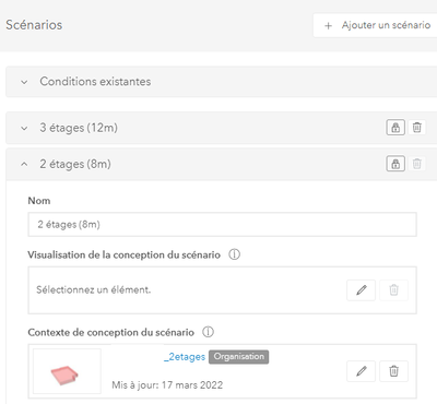

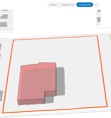

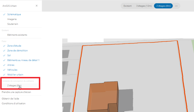

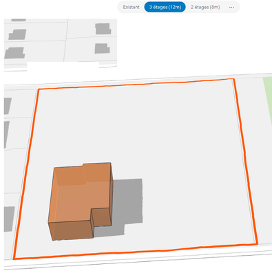

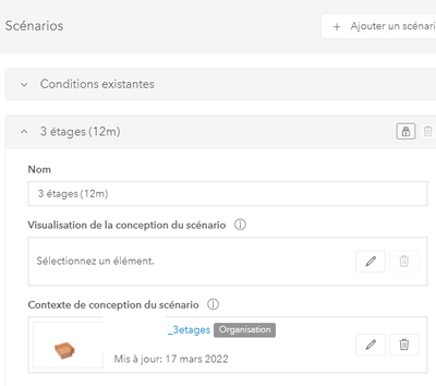

Hi @DominikAllemann , thank you for the quick answer.
The scenario buildings that stay visible when changing scenarios are loaded for a web scene.
In this project , we have 2 scenarios. No existing buildings for this area.
The first scenario is a 12m height building
The second scenario is a 8m height building
But if i switch between those scenarios, we can see the other scenario building.
To make sure that only the 3étages(12m) is the only one visible in this scenario, i have to desactivate the 2étages (8m) building, in the other scenario .
Is it normal that those scenarios are inter-connected ?
Thanks.
