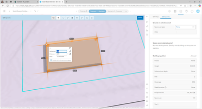

Hello,
The workflow to achieve this would be to first build the first ground floor part (the 200' x 120') retail space
you can hit the tab button on your keyboard to be able to enter the exact dimensions (see screenshot below)
Next use the snapping capabilities to create the second part (the garage space behind the retail space),
And finally, you can just create additional floors spanning both ground floor parts. Adding 2 garage floor and 9 housing floor, you final building will look something like the screenshot below,
