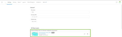

Hello.  I have recently altered my Urban model by attempting to upload a new hosted .slpk as my existing buildings layers for schematic visualization & satellite visualization, yet after assigning the .slpk it will not appear in Urban (this .slpk is accessible for all members of my organization.)
Here is a screenshot of where my .slpk should be generated.

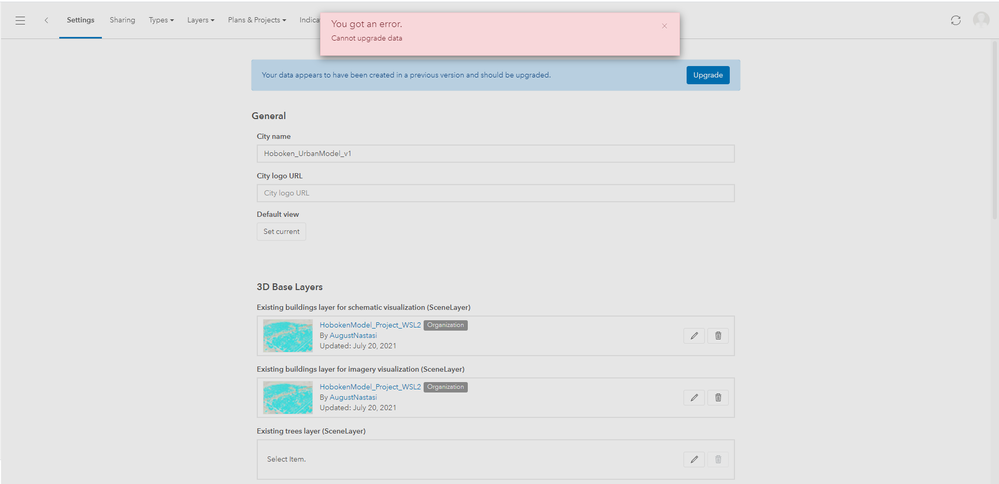

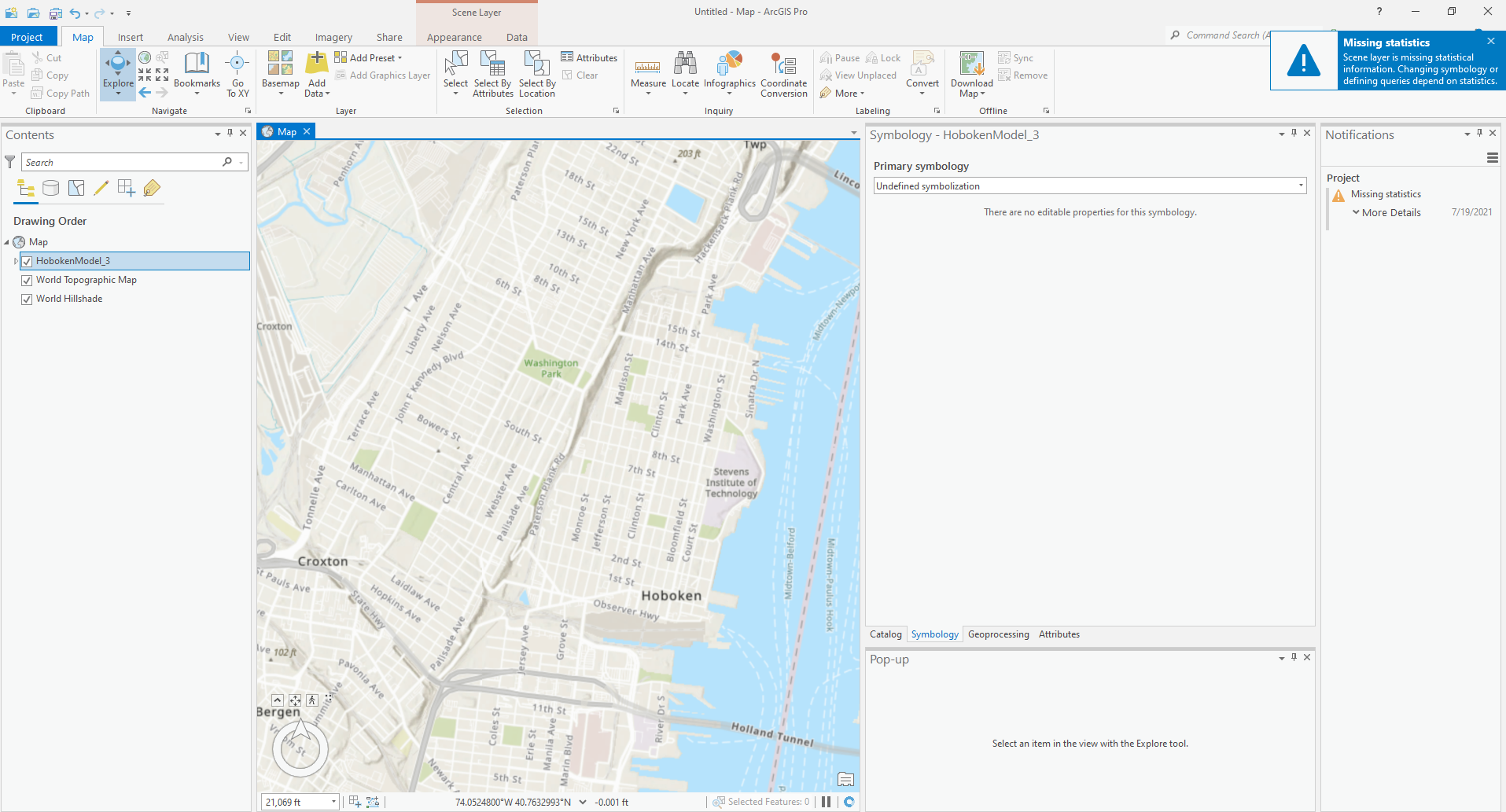

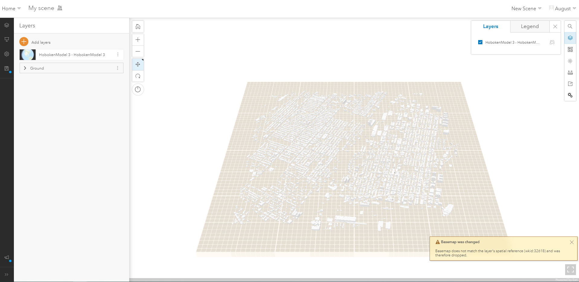

When I open this hosted .slpk in Scene Viewer and ArcGIS Pro the .slpk is able to displays with no problems, however each platform displays a different error message that may indicate as to what is causing this problem in Urban.
Scene Viewer: Basemap was changed.png
ArcGIS Pro: (The .slpk generated after this screenshot was taken)

Please make sure that your existing buildings layers are in the web Mercator (auxiliary sphere) coordinate system (EPSG code 3857). This is the coordinate system that is being used in your urban model.
Looking at the 2nd screenshot you've shared (the one showing your existing buildings in the scene viewer), it looks as if your data might not yet be in the web Mercator coordinate system.

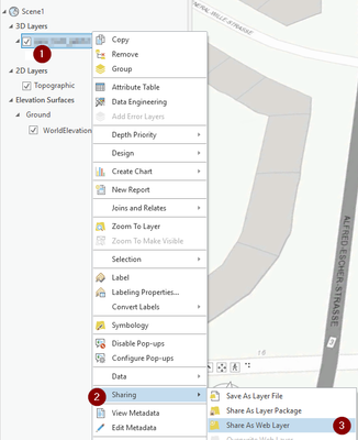

In case you are having the raw data of your existing buildings at hand (i.e. not the slpk), I'd suggest loading the data into a global scene in ArcGIS Pro and re-publish it again from there (see attached screenshot).

Thanks for that Dominik.  While my existing buildings layer now appears in my Urban model briefly, it then disappears.  Could this possibly have to do with upgrading my data due to todays Urban update? I was having trouble with that as well.
