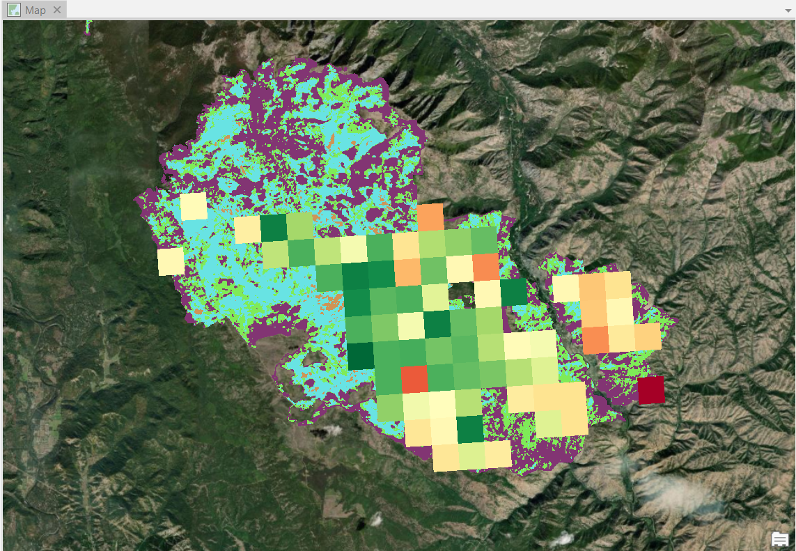

Running a weighted sum analysis of raster data- a way to "smooth out" the output?
756
11-10-2020 11:01 AM
MichelleZelenka
Hi, I am trying to run a weighted sum analysis of raster data. When finished, the cells of the output look very large and pixelated. I was wondering if there was any way to "smooth out" the output to look more like the data shown below it. Attached is a s
DavidPike
MVP Notable Contributor
Lovely! I think an environment such as cell size is coming into play and 'maximum of all inputs' or whatever is being used (i'm guessing one input raster matches this large cell size?).
take a look at the Environment tab of the gp tool and cell-size
Geoprocessing environment settings—ArcGIS Pro | Documentation
