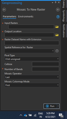

JayantaPoddar
MVP Alum
What format are the input rasters? Ensure that the input rasters have same number of bands and same bit depth.
For Landsat 8 image inputs, you may choose 16-bit Unsigned as the Pixel Type.
Alternatively, you may also keep the output in a TIFF format (*.tif).

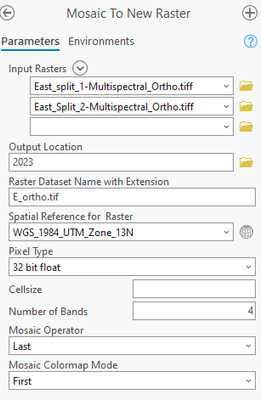

WilliamMecier
I tried all of the suggestions in this post, ultimately finding that when I used a .GDB for my output location the tool would fail. I suggest choosing an output location that is just a folder on your system. Hope this helps.
IoannisSvolos
"I suggest choosing an output location that is just a folder on your system"
this solution helped me too. Is there a reason why a .GDB as output location doesn't work?
