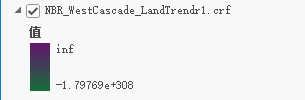

EXCUSE ME. Recently,I use the data provided by the LearnGIS Lessons(Forest_Disturbance_Analysis.zip),and work with the course(https://learn.arcgis.com/en/projects/monitor-forest-change-over-time/) step by step to learn the LandTrendr .But it just costs me 30s to get the result .(The process may run for 15 minutes generally ),but the result is not show on my screen.The following picture is my result.

Hi Yuhang, could you check two things?
I noticed there is a space in the extension of the output file name (. crf), could you check whether that is the cause?
I also noticed that you were running on a machine of Chinese operating system, would it possible  to try on a machine of English operating system?

Hi, Very happy to receive your reply.I ran the algorithm in version 2.8 and there was no error, so I think it may be that I did not properly configure the environment required for version 3.0, of course, it may also be a problem that you pointed out above. Sorry for not giving you feedback in time whether my problem is solved.
