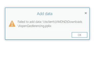

Hello all,
I am attempting to open the exercise file associated with the Georeference imagery lesson in ArcGIS Pro. I am running ArcGIS Pro via VMware and get the following error message.
Any advice would be greatly appreciated!

Hi Melissa,

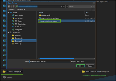

How are you opening this project? You can open it in one of two ways:
1. Navigate to your downloads folder and double click the AspenGeoreferencing.ppkx file.
2. Open ArcGIS Pro. On the welcome screen, in the bottom corner, click Open another project. Navigate to and select AspenGeoreferencing.ppkx and click OK.
If you were already doing one of these methods, please tell us at what point the error appeared. What did you do just before you got that error?
