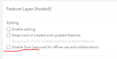

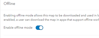

Thanks. Do you know why I can't take this layer offline to collector or field maps?
MehdiPira1
Hi @CassiePorter
To make the feature layer to work offline, here are the steps:
1. Go to settings of the feature layer and enable sync
2. Create a web map from this feature layer, you can include other feature services/layers as well
3. Go to settings of the web map once it's created and turn on the offline mode and save it.
